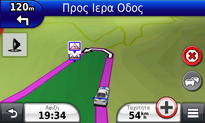

I would like to inform you about some problems that me and other members of a small Greek forum facing with the operation of our nuvis when we use City Navigator Europe NTU, this behavior have been encountered to 2012 series nuvis (25x5, 24x5, 34xx, 35xx). With older releases of NTU map until now with version 2013.40 nuvis have trouble to complete a route when languange has been set to Greek. Just when Parking symbol appears device freezes, user has to close it by holding On/Off button for a few seconds. Older nuvi devices that use City Navigator Europe NT don't have the same behavior even after thousands of km traveling in Europe.

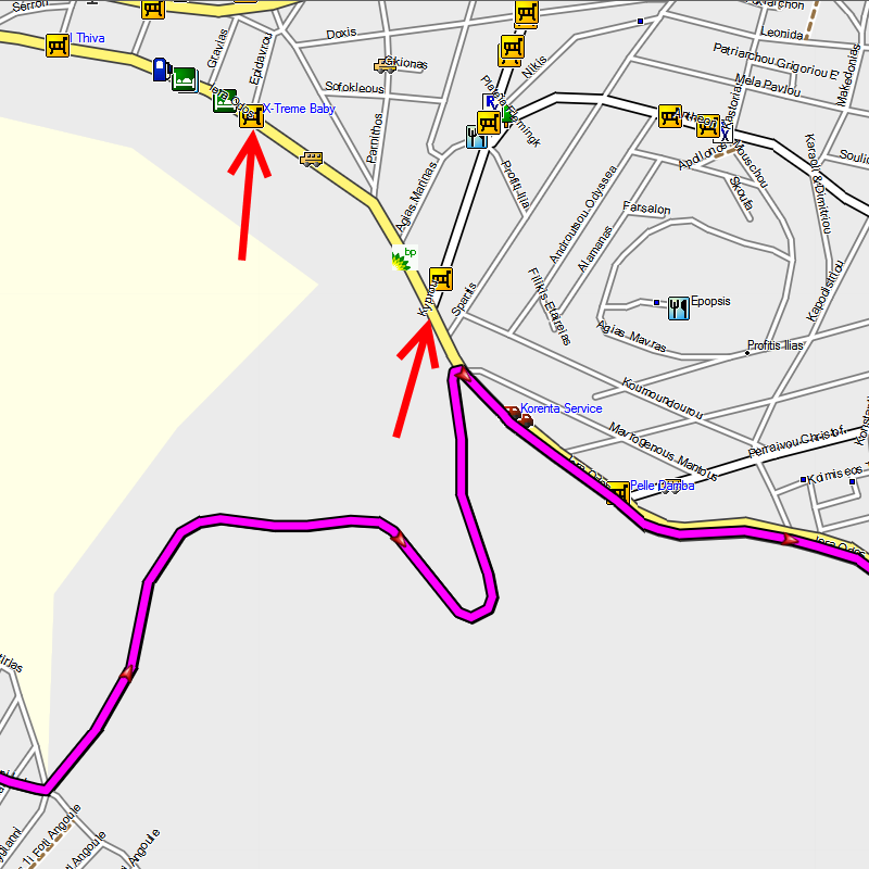

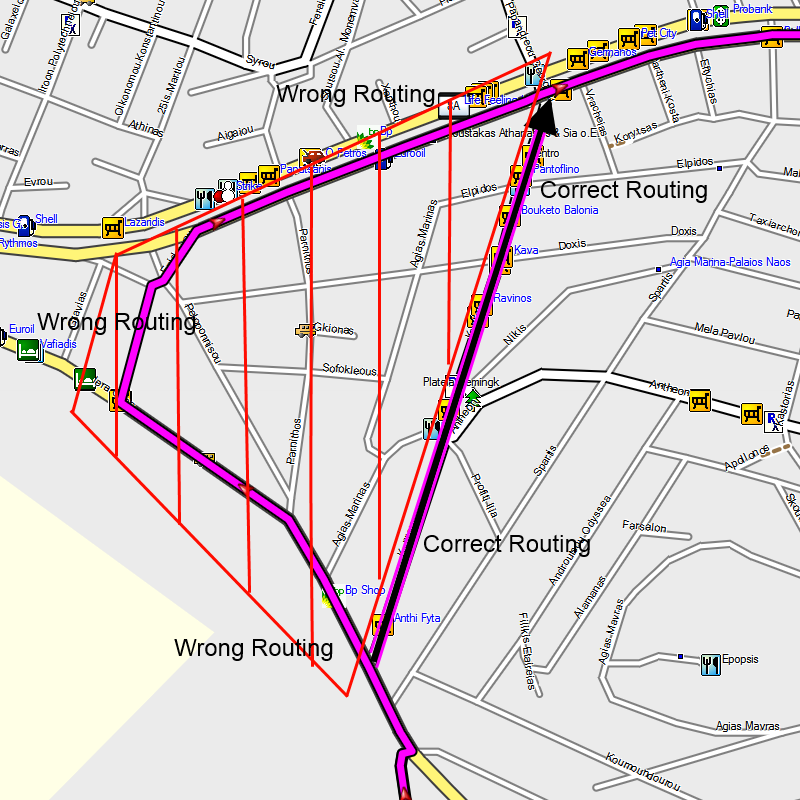

A second issue has to do with strange routing that nuvis using the NTU version seems to give sometimes. For example:
Black color is the right route to give but for some reason device suggests the red one.
Another example:
Instead of keeping the route on the main road (yellow color) device suggests the red colored one.

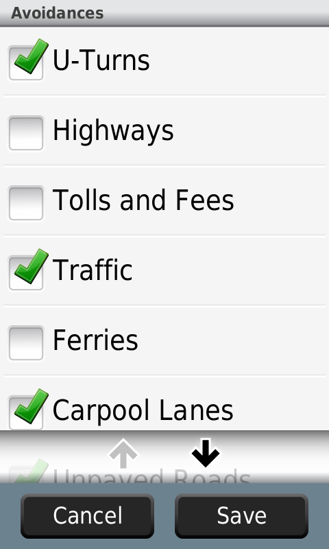

Avoidances
U-Turns
Traffic
Carpool Lanes
Unpaved Roads

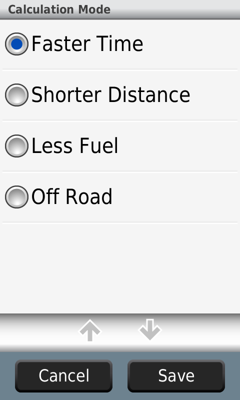

Calculation Mode
Faster Time

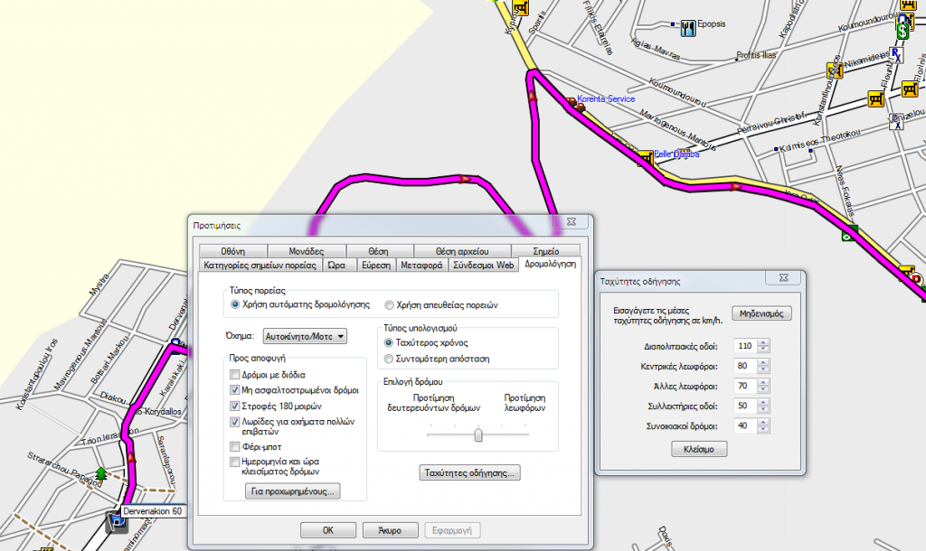

If we use the same NTU map in MapSource or BaseCamp routing is very good with no problems. The problem seems to improve if the user rename SID & SQLite folders, clears Travel History and deactivate it together with trafficTrends.

    The main problem for us in Greece remains the routing problem when we use CN Europe as i metioned in first post. I did some tests using nuvi 3490 with City Navigator Europe 2013.41 and i would like to give you the results
    Routing Test No1
    Search By Address
    Start Point
    Dervenakion 60
    18122 Korydallos, Attiki
    Destination
    Kanari 60
    15344 Gerakas, Attiki
    The correct routing as it shows in the screenshot above, is as Auto Drive Hellas 2.40T (Greek local map provider & representative of Garmin in Greece) and Navigon 4.80 Android with Navteq 2013.Q1 gives it.
    GPX file with the route sent from my 3490 to MapSource.
    Devenakion To Kanari Routing By Address Search With City Navigator Europe: http://www43.zippyshare.com/v/52134702/file.html
    Devenakion To Kanari Routing By Address Search With Auto Drive Hellas: http://www18.zippyshare.com/v/91113104/file.html
    Routing With Trip Planner in simulation mode.
    Start Point
    Dervenakion 60
    Destination
    Kanari 60
    When i use Trip Planner the device gives me a different route from the one when i use the Search By Address function.
    Devenakion To Kanari Routing With Trip Planner and City Navigator Europe: http://www43.zippyshare.com/v/21552418/file.html
    Routing With Trip Planner or Search By Address in simulation mode without SID and SQLite folders
    Start Point
    Dervenakion 60
    Destination
    Kanari 60
    Devenakion To Kanari Routing With Trip Planner or Search By Address in simulation mode without SID and SQLite folders and City Navigator Europe: http://www43.zippyshare.com/v/69793499/file.html
    Routing In MapSource With Search By Address
    Start Point
    Dervenakion 60
    Destination
    Kanari 60
    Devenakion To Kanari Routing In MapSource With Search By Address: http://www44.zippyshare.com/v/292931/file.html
    According to Navteq's site the right routing is as shown here: http://her.is/3TQHS

    Here are the settings i always use for routing in 3490 & MapSource:
