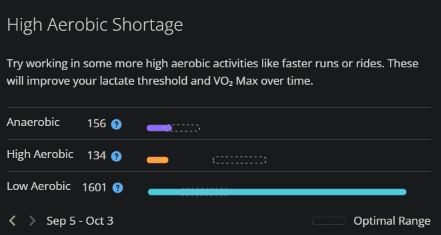

Like others before, my High Aerobic is reading zero.  This has happened before.  I understand from other discussions on this site that it may be a settings issue, but I have Low Aerobic and Anaerobic scores, but zero for High Aerobic.  There must be some action in High Aerobic to be able to transfer to Anaerobic, right?
Here's my ride from the weekend...
https://connect.garmin.com/app/activity/24500056018
I understand that it is registered as Base Training Effect, but zero High Aerobic?  How come?

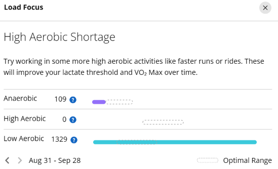

    I have exactly the same problem. With my last training

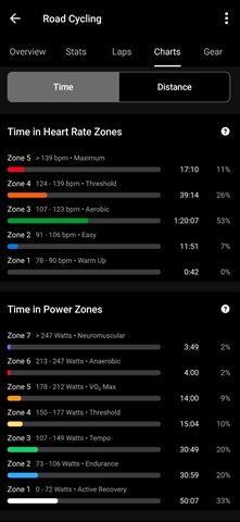

    In your case, you've spent 90% of the activity time in low aeroby (HR Zones 0 to 3). Assuming your HR Zones are based on the true LTHR…
  • 156bpm really is as high as my heart rate goes.
    In that case, it looks like your HR Zones are quite off. If your Max HR is 156, then the HR Zone 5 should start at 148 bpm, and not at 139, as…
