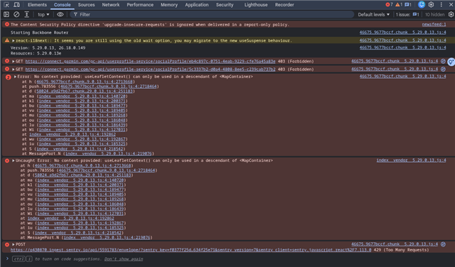

    • This is the console output. The last three items appear when the feed blanks

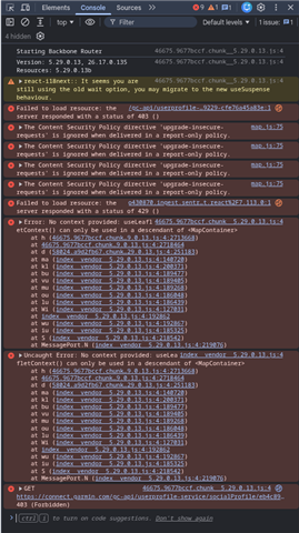

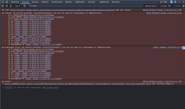

  • It has to do with activities that show a map. For example I can now open it because the ppl on my news feed happen to either upload photos or do activities without gps (like yoga or strength). Once you start scrolling down and activities that have navigation should load the page just goes blank and shows nothing (the central page, the menu and the rest still work as intended). In the developer tools I get a lot of exceptions on the JS side that have to do with Leaflet.
    Update: As per Claude and passing the exceptions:
    Common causes:
    • A map child component (marker, popup, layer control, etc.) is rendered in the DOM tree but not actually nested inside <MapContainer>...</MapContainer> — maybe it's rendered via a portal, a separate route, or conditionally before the map mounts.
    • The map component tries to render before <MapContainer> has finished mounting (e.g., a race condition tied to that fetchMapPreferences call in the trace — the data comes back and something tries to render a child of the map before the map itself exists).
    • A refactor moved a component out of the <MapContainer> tree but left it using Leaflet hooks.
    Looking at the trace, this fires right after fetchMapPreferences resolves. It's during page navigation to the "newsfeed" page (Window.App.NewsFeedPage), so it looks like a map-related widget on that feed is trying to render without being wrapped correctly, possibly because of how/when the feed data loads relative to the map mounting.
