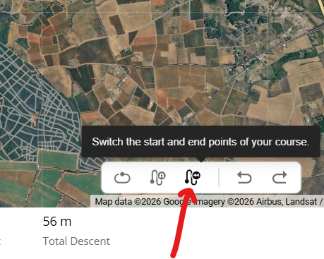

I have created a course on Garmin Connect web (https://connect.garmin.com/app/home). I would like to reverse the direction of the course but I can't see the option to do this when I select the Edit button. Can anyone help with this please?
Edit the course, and then select this option:
On most Garmin watches, you can also navigate the course in the reverse direction, without having to change the original course.
