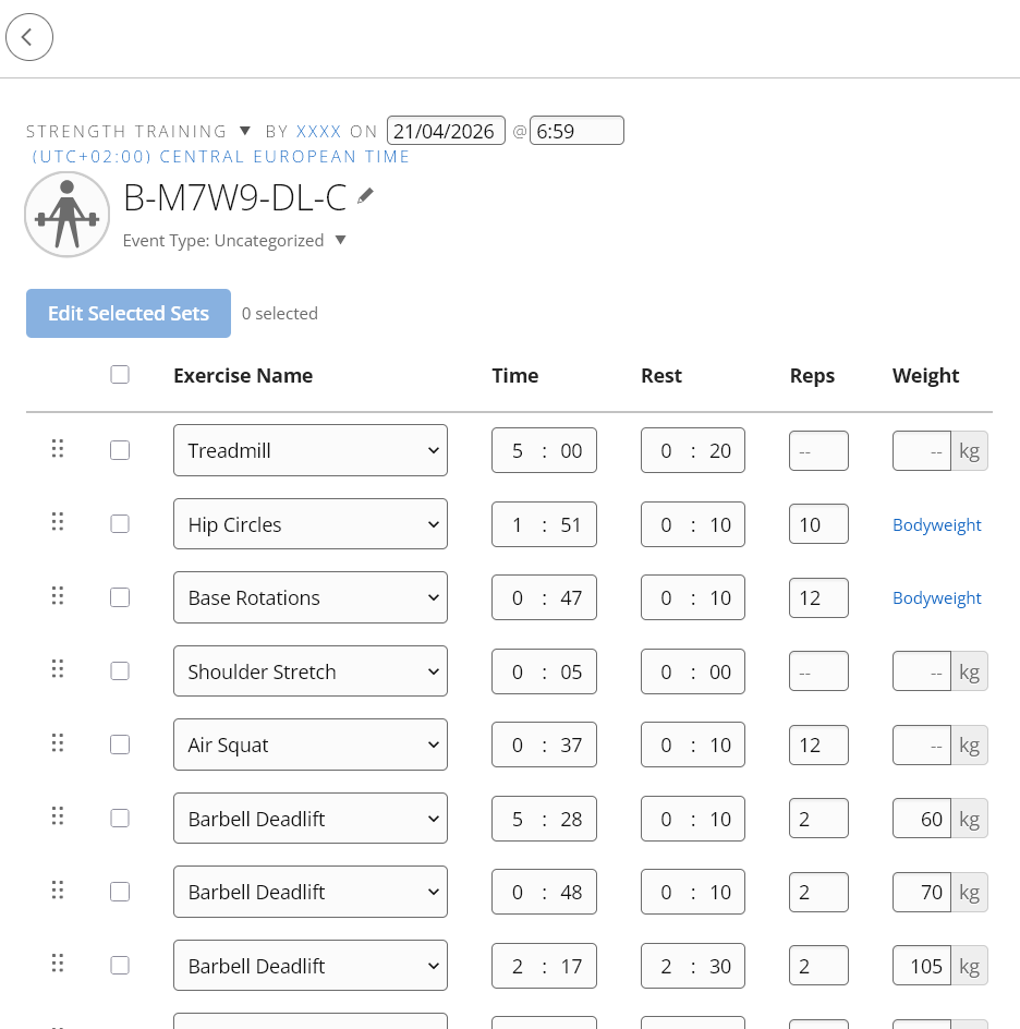

The second bug affects the activity edit mode. Before the UI changes, the trash icon used to delete it a step was visibile on the right. But now the new UI made elements so big to the point that such icon is no longer visibile. I need to reduce screen size to 90% to get it working even if I have a 21:9 display.

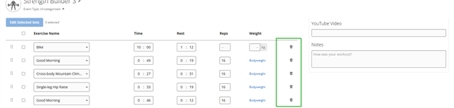

  • I am seeing the 1st issue when trying to open strength workouts from the calendar. It's only strength workouts though as I can open runs/walks/yoga etc.  As for the 2nd bug, I can't replicate what you are seeing as I can see my trash cans just fine:

    As for the "trash" icon, I noticed after opening the post that it only becomes visible if I reduce the browser zoom to 90% or close the sidebar. This happens even though I'm using a 21:9 display (3440x1440) and have Garmin Connect taking up exactly half of the screen.
    It looks like, with the latest update, they increased the padding and margins so much that now I have to remember to either close the sidebar or zoom out to 90%.

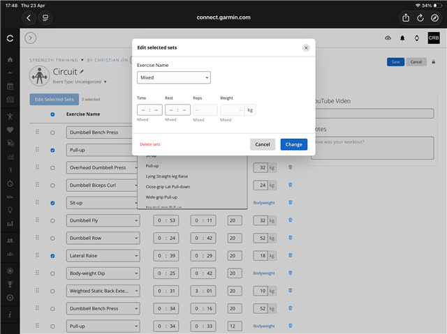

  • There’s a similar issue with changing multiple exercise types, the drop down list appears behind the edit box! Totally unusable. You have to revert to changing each one individually.
