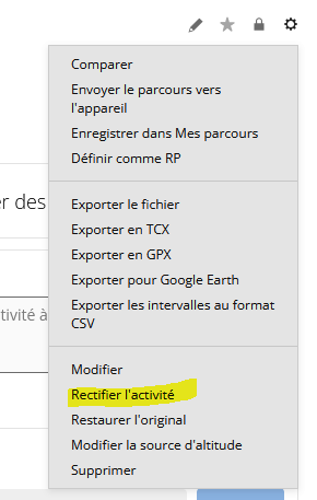

    Yes. I "rectified" the activity with Garmin Connect (edited it if you prefere). it's "Rectifier l'activité" in french in the menu of the activity:
    It's an activity recorded on my FR970 an synchronized in Garmin Connect. I edited it (and other VTT activities) with Garmin Connect. As I said, for this activity in the example, I deleted just few points before (8)  and after (6) with Garmin Connect and registered it. The activity has been modified in Garmin Connect. Therefore, the fit file in Garmin Connect is always the same than before the modification. I don't understand why we can't export the new edited fit file.
