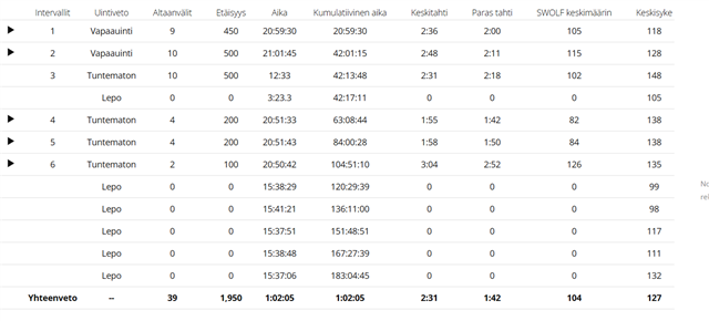

Sorry about finnish, but lepo is rests. Rest was like 3 min or less. And only between intervals. Swimming data editor says rest time like 2100 min.
I have already seen couple of similar cases here on the forum. Usually it was due to some weird timestamp corruption, and the fix was trimming a few seconds from the beginning of the activity. Unfortunately, you cannot do it directly in Garmin Connect. First of all you have to change the activity type to a type where trimming is available (i.e. Running), trim a few seconds from the beginning, and then change the type back to Pool Swim again. No worry, no data gets lost (and the original can be always restored without problems anyway).
