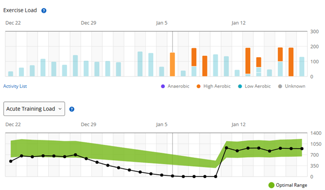

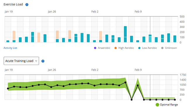

My Acute Training Load occasionally drops to zero for no apparent reason, even though I have been training almost daily.
I’m trying to understand if this is a bug or if something in my device setup could be causing it.

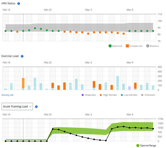

    Below are a few examples comparing my HRV data with the Acute Training Load during the periods when the issue occurred.
    On February 19th (the one highlighted above), for example, I had a 1h20 swim session in the morning (Base - Low Aerobic) and a 1h45 bike session at night (Threshold - High Aerobic).
    My HRV was updated and my HR data was recorded throughout the entire day. Despite that, my Acute Training Load still shows zero.
