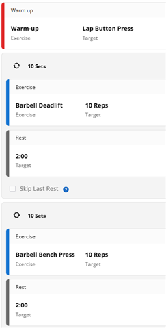

  • I once had a suggestion to make run trainings more similar to strength training where you can "skip a exercise" but never got any response..

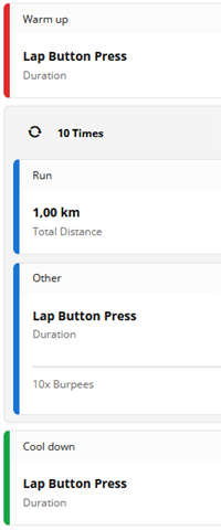

    This is not what this thread is about so it does not really matter.. but i meant it differently.  My problem back then would have been a training like this:
    Some days i might only want to do 5 repeats instead of 10.. currently i would have to press the lap button 10 times to end the last 5 repeats of run/other .. or end the training. Or create two trainings..
    If this were a strenght training there is the option to skip a group..
    I hardly ever do 10 sets but its super easy to skip from Deadlifts to Benchpress.. "press start, select skip group".  No matter how many sets a plan to do, i can use this training for training 3 sets, 5, sets , 10.. really would love to have something similar for run trainings.
    I understand that both training types are different and that run trainings can have repeats of repeats, guess that why it would be much harder to have s simple "skip repeat" but one can still wish for it..
