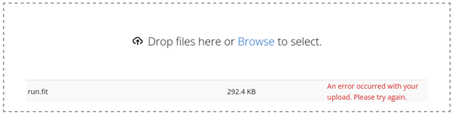

Cloudflare blocking me from uploading fit files
Opening dev tools:
Sorry, you have been blocked
You are unable to access connect.garmin.com
Why have I been blocked?
This website is using a security service to protect itself from online attacks. The action you just performed triggered the security solution. There are several actions that could trigger this block including submitting a certain word or phrase, a SQL command or malformed data.
What can I do to resolve this?
You can email the site owner to let them know you were blocked. Please include what you were doing when this page came up and the Cloudflare Ray ID found at the bottom of this page.
  • I was also blocked from posting on the forum, but that seems fixed now?
    Anyway, I have an activity on my watch that just refuses to sync to Garmin Connect. I have downloaded the .fit file, made sure it is valid by checking it on fitfileviewer.com. But whenever I try to manually upload, I get the "An error occurred" above.
    Looking at the Dev Tools, I see HTTP 403 Access Denied, and when I open the Response it seems to be a Cloudflare block page.
  • Converting to a .tcx file and then uploading DOES work by the way. But the conversion loses a lot of data in the process to the point of the file become unusable.
    Did you use a Connect IQ data field which records to the FIT file?
    It would be funny if it records a field with a name containing text that cloudflare doesn't like for some reason (like "alert" or some other built-in javascript function name).
    If it's the case that you recorded with a new Connect IQ data field that does record data, you could try to use https://fitedit.io/ to look at the FIT field name(s) and possibly edit them.
    You could also use it to try to find and edit any other textual data that could be causing the problem.
    If it's not textual data that's triggering the error, then you're probably out of luck. (Because it will probably be impossible to figure out exactly what the problem is.)
    Unless ofc you contact Garmin support directly and send them the problematic file. Then they might be able to help you.
  • There are no custom Connect IQ Data Fields. It's just a regular Running workout, imported from Runna, with the name "W14 - Thu Tempo Half Easy, Half Tempo." I have edited the name to something more "safe", without dashes or the comma but that doesn´t resolve it.
    This is a run like any other I've done dozens of times before. The fact that the run also refuses to sync from my watch to Garmin Connect makes me suspect that *something* is wrong with it but every tool I've used so far confirms it is a valid file with no issues.
