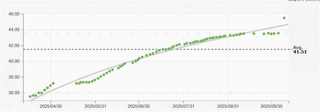

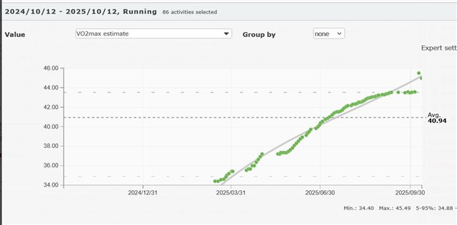

  • Here is my VO2max chart so you can see the big jump.

  • Above is a 2 point jump in VO2max
  • Where are you getting these numbers from? Runalyze? I know that with Connect, it's only possible to get numbers to 1 decimal place, and not with the frequency that you have in the posted graph [*]
    Note that runalyze's "VO2 Max from file" numbers are a bit problematic:
    - for running activities (which produce a VO2 Max), they represent the *activity VO2 Max* (which is related to, but not the same as the user VO2 Max which is what is seen in Connect and on the watch)
    - for non-running activities (which do not produce a VO2 Max), they represent the user VO2 Max
    For example, if I record basketball and running activities on the same day, runalyze's "vo2 max from file" numbers for the respective activities will be inconsistent because the running activity will show "activity vo2 max", and the basketball activity will show "user vo2max". A basketball activity recorded after a running activity might show a spurious 0.05 jump in VO2 max due to this (because the 2 numbers don't represent exactly the same thing) - this is especially spurious since VO2 Max is not calculated for basketball activities, which means it shouldn't be possible for a basketball activity to produce any change in VO2 Max.
    So not only are runalyze's VO2 Max numbers not consistent with Connect (usually), they are not consistent with themselves (as runalyze vo2 max from file could be either activity vo2 max or user vo2 max).
    If you really want to see the user VO2 Max (same as Connect) with 2 decimal places, you need to export your activity FIT files and open them in fitfileviewer.com. There you will see both user VO2 Max (at beginning of activity, matching what's in Connect) in the user metrics table, and activity VO2 Max (at the end of activity, matching what's usually in runalyze) in the activity metrics table.
    [*] The Connect app's graphs will show unrounded graph points with decent frequency, but there's no way to get the unrounded *values* this way (hovering over the graph shows rounded values). The Connect website is similar to the app, but has fewer points (e.g. even the 7 day view has fewer than 1 point per VO2 Max-generating activity or day) - however, you can export the graph to CSV and see the few points that are graphed with 1 decimal place.

    However, I was thrown a bit of a curve with the big jump.  And just today, I did a 2.5 mile run at my more normal pace of 10:35 and RUNALYZE chart shows value of 44.97, another big jump relative to the rest of the trend.  Please note - this time I used my FR245.  I plan to alternate my watches on future runs just to see what happens.  So last 2 runs, first with 630 then with 245, the values simply don't fit the historical curve, substantially.  My weight is the same, conditions similar, 2 different watches but I did change my resting heart input for zones from 75 to 60.  Beginning to think this has an impact.
    Anyway, I appreciate your input on this and will read your message again to try to get more insight on this VO2max stuff.  However Garmin / Runalyze are coming up with values, I have a trend telling me I have really peaked in this area, aside from a couple of strange outliers.
    Here is latest chart:  Last 2 points are from the 630 then the 245
  • From fitfileviewer, the last 4 dots in the chart are 43.47, 43.52, 45.00, 44.72 (user metrics)
  • And runalyze indicates 43.52, 43.56, 45.49, 44.97.
