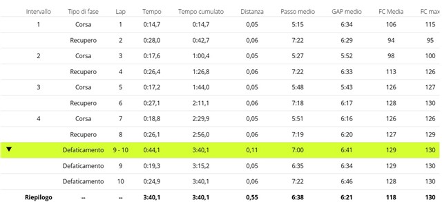

Hi all! In the following table the first lap lasts 14,7 sec. and the distance is 50m, the pace should be 4:54, why GARMIN calculation is 5:15?
I have thought that in GARMIN CONNECT the distance 50m is "approximated", a bit different from the reality. In fact, if it was 46 meters the pace is right 5:15.
If this is correct, it means that GARMIN approximates 46m to 50m. What do you think?
Thanks!
