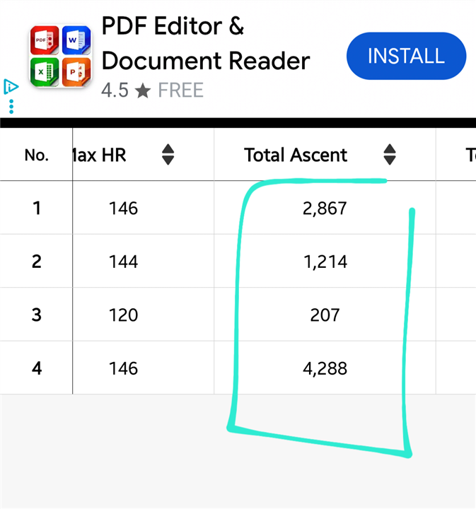

    UPDATE; In neither a FIT file download (using the online tool you suggested) or CSV download are elevation tenths shown as you claim. it's all whole numbers.
  • UPDATE; In neither a FIT file download (using the online tool you suggested) or CSV download are elevation tenths shown as you claim. it's all whole numbers.

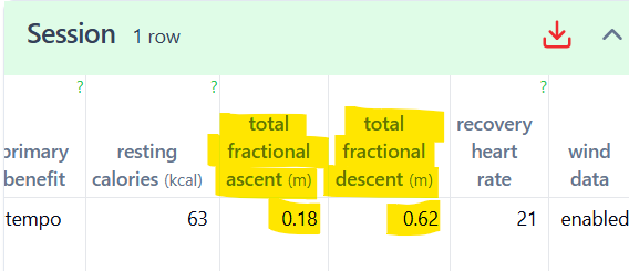

    You are looking at the wrong place. The unrounded values are available here:
    It is actually recorded with the accuracy of 2 decimal places (1cm), hence ~0.03 feet. The accuracy of 0.1m is in the Splits table.
  • How are those "unrounded values"? They are reported values IN the same file. It's as though you're conflating the accuracy that they report (0.95 to 0.99 for believability that 8000ft is accurate, it's a confidence level) for elevation as meaning they go out 2 decimal points BUT don't show you said decimal points on any part of the file?? Yet they show them in other reported numbers?
    "Aaccuracy" (which isn't the final elevation value, accuracy is how accurate the elevation value is, not a method to then offset the total calculation by). BUT the fact is, the whole number ascent IS shown in whole numbers as I've been saying. The same file is showing the whole number but you're claiming it's not actually using the whole number in it's calculation.
    So what you're saying is so convoluted if you think about it.... The online reports shows elevation as a whole number, the CSV shows a whole number, the FIT file shows a whole number, my watch shows a whole number BUT it's doing its "total" calculation on a non whole number??? Even while not tweaking other numbers that are shown, reported & totaled out to tenths (like speed which shows tenths and calculates totals in tenths). Nothing actually shows any elevation as say 4287.7.ft. But you're claiming these 0.95 (mine is 0.99)  fractional ascent numbers (which is ACCURACY of the reported amount NOT an unadjusted elevation amount) suddenly means that behind the scenes total calculations on JUST elevation (& no other reported numbers mind you) are not done on the reported whole number, but on this fractional accuracy. "accuracy" isn't a reported stat, it's the believability & accuracy of the reported stat. And every single thing relative to elevation is being shown as.. whole numbers.

    Most values are recorded with higher precision than displayed. Just an example from a random activity file:
    • distance: displayed 6.10 km vs 6,104.58 m (6.10458 km) recorded in the FIT file
    • total time: displayed 43:38 vs 43:38.143 recorded in the FIT file
    • avg stride: displayed 0.86 m vs 862.3 mm (0.8623 m) recorded in the FIT file
    • avg respiration rate: displayed 37 brpm vs 36.58 brpm recorded in the FIT file
    • VO₂max: displayed 55 vs 55.17 (resp. 54.7119 1st VO₂max) recorded in the FIT file
    • etc, etc
