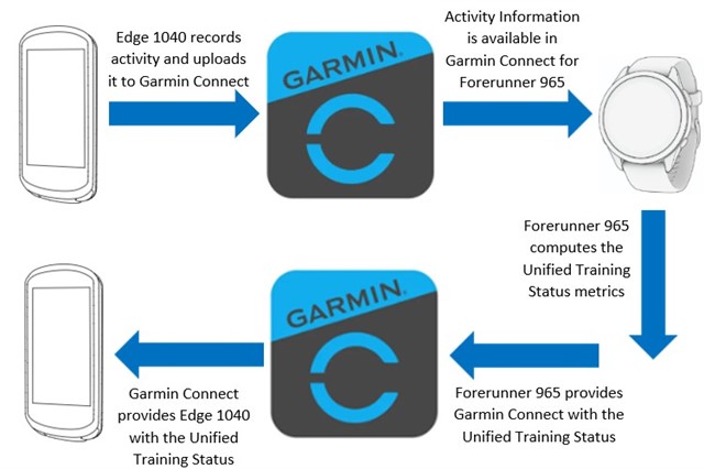

  • Beside what suggested, the following article, and especially the image below can help you understanding how the devices communicate with each other:
    What is Unified Training Status? | Garmin Customer Support
