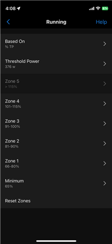

  • Oh, now I get it. It is, though. It is not set to "Watts" but to %TP. I´ll add a screenshot to this answer, if that helps. If I switch to Watts, my Zone 3 ends kind of like the way you said. Maybe you can help me out now with the information provided.
  • As you can see, the Zone 3 should be 91-100% of your TP of 376 W, but the screenshot of your activity shows the Power Zone 3 of 281-311 W instead. So either the TP was lower at the moment you started the activity, or there is some problem with the Power Zones table. That's why I suggested resetting it.
  • I see, I see. But the thing is - I haven´t changed those settings ever. And when I first discovered the discrepancy I immediately looked up my power zones, reset them and they've been like this for months now. Plus my TP hasn´t gone up drastically, just a small bit that should never cause this. I have now reset it again and it shows the same percentages - I´ll check back tomorrow as I haven´t been on a run for some days now due to a slightly inflamed achilles. Is there any logical explanation though why it says 91-100% on the table but on the activity screen it´s completely off? I am running with the Epix Pro and a HRM pro, btw.

    The table from the Connect settings in your screenshot shows zones as they are configured now, while the one in the activity shows the zones at the time the activity was recorded. For example, changing zones in Connect settings now wouldn't affect the zones that are displayed in an old activity.
    Ofc since you haven't changed your zones, and your TP hasn't changed that much, both tables should be similar (or identical). But in general, it's possible for the 2 tables to be different, especially if you are comparing an old activity to your current settings.
    In your case, this could point to some bug where there's a mismatch between your device settings and the settings in Connect.

  • Wow, thanks for the very detailed answer. Although I have to say that I never thought that already completed activities would change. I just stated that I never reset the zones and the setting have been the same for quite some time. The original activity I posted was from a few days ago and in the meantime since discovering this I reset them a few times. As I did yesterday and I went for a run today post injury. This was neither a recovery nor a tempo run, it was kinda like getting back on track with a few faster segments here and there but mostly base pace around 4:45 ish per km. I´ll add a screenshot and it might help if it seems correct now. I guess they still don´t match exactly but that will never be the case. Can´t compare HR and power and treat them as equal zones. I also did it on the watch, like you said. Tomorrow will be a long run and no real faster or slower segments albeit quite some elevation gain. But since I have never really had quite accurate and just blatantly off zones, I guess it can only be better. Let me know what you think of the added pictures, I assume everything seems "more correct" now.

    So what I was saying you could do a couple of double checks to make sure that everything seems to working properly (e.g. that your power zones in the watch settings on the watch itself match what's in the Connect app watch settings). But I don't think it's necessary, as your power zones look correct now, after resetting them as trux suggested.
    e.g. Zone 3 is supposed to be 91% - 100% of FTP, and in fact that's what it is now (376-431)
    It does look like your time in zones percentages for HR and power are very close now, so it looks like everything is working properly.
    What might have happened in the past is that even though your power zone percentages were right, there may have been a bug making the actual numbers in watts incorrect? That's why trux asked you to reset your zones, and it looks like it did the trick.
