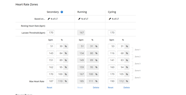

I cannot set heart rate zones for the new forerunner 965 in garmin connect web, I have set this watch as primary wearable, primary training device is my edge 840,
when I choose forerunner from devices I don't have any setting, only information "Use the Garmin Connect app to manage your device settings."
When I choose edge 840 the I see here heart rate zones but I can set zones only for cycling, for running the threshold box is greyed out:
  • when I choose forerunner from devices I don't have any setting, only information "Use the Garmin Connect app to manage your device settings."
    Like the message suggests, HR zones can't be set from the Garmin Connect website for FR965, only from the Garmin Connect app, or on the device itself.
    https://support.garmin.com/en-CA/?faq=w8qlOr7BQ16Z82HVrevpw9
    NOTE: Models that support Real Time Settings via the Garmin ConnectTm app will not have the option to edit device settings in Garmin ConnectTm web. For more information including Garmin models that support this feature see: Real Time Settings in the Garmin Connect App.
    I don't own an Edge, but it seems to me that you can't really use the Edge for running activities, which might be why the running zones are greyed out? (idk how they were populated in the first place tho. Could be that you were able to set them once, but you can't anymore?)
