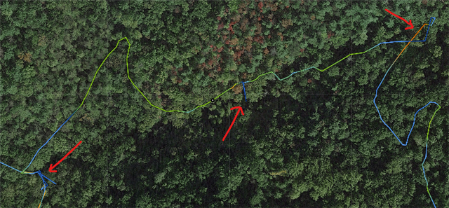

  • Your friend's activity is not accessible publicly. He would have to open it to Everyone in order to allow us to compare it with yours.
    However, when you check the track, zooming-in, it looks like the watch partially lost the GPS signal couple of times, under the dense vegetation, and due to decreased accuracy, some extra artefacts appear on it. See below 3 of them:
    That alone can add some extra distance. Some more distance seems to be added by the corrective algorithm, trying to compensate for the GPS errors, using the data from the internal accelerometer. Usually it works fine, but it assumes, the watch is properly calibrated. And if you walk often in deep forests, or in narrow valleys, the lower quality of GPS signal can skew the calibration.
    You can see the difference added by the corrective algorithm when you save the activity as Course, in Garmin Connect Web. It reveal the true distance of the GPS track (without the correction). In this case the GPS track is 9.18 miles long, instead of the 9.5 miles reported by the activity. It means the correction done by the watch adds an extra 0.32 mile to the GPS track distance.
    The calibration can improve after resetting the watch to factory defaults, and recording couple of hours of outdoor GPS activities, under good GPS conditions (open space with visible sky in all directions, no dense vegetation, no mountains, buildings, or wall in the direct proximity). Newer watches use more advanced GPS technology, allowing to cope with bad GPS conditions better than it was the case with Fenix 3.

  • The distance of his GPS track (w/o the correction) is 8.99 miles, which is not that different from yours of 9.18 miles. It is a difference of 2%, which I believe would be pretty acceptable, considering the conditions. However, in his case, the watch is better calibrated, and corrects the distance in the right direction, hence reporting less than the GPS track - 8.90 mi. Your watch does the correction in the opposite way, and reports 9.49 mi, which increases the total difference to ~6%.
