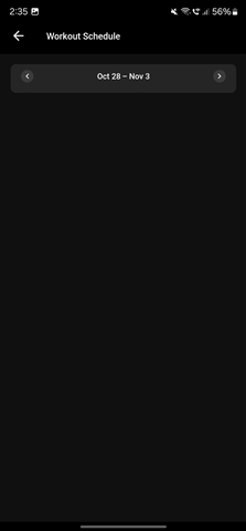

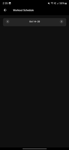

Hi, I woke up today and checked as usual my workout of the day following the start of my Garmin Cycling Coach plan 12 days ago. This morning, after restarting my Garmin Edge 1040 to fix a display issue with the training session of the day being the one of the previous, all my previous workouts and scheduled workouts disappeared from Garmin Connect Web and Garmin Connect Android mobile (see screenshots).

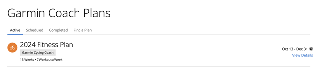

On Garmin Connect web, the page is even blank if I try to see the schedule for next week. They still appear on my Edge 1040 though. Garmin, can you please fix this issue?
Garmin Connect mobile:
Garmin Connect web:
  • As suggested in another thread, I quitted my current plan and created a new one with the same settings and scheduled workout are back and seems to be the same. Will see how it goes in the next few days.
  • Ok. I just reproduced the exact same issue. If I turn off completely my Garmin Edge 1040, then start it, sync it with Garmin Connect on Android. The scheduled plan in Garmin Connect is erased completely.
  • Hi, it seems i have the exact same problem since last night. Garmin Connect mobile shows no workouts planned, Connect web shows a blanc page and my Fenix 7X shows different workout schedule then my Edge 1050 for the next 4 days. I believe this started with the last updates. It's a shame you create a good training ecosystem from the same brand but you discover that the pieces don't really work together :(
  • I think that Garmin is going to address that in the next release. For the Edge 1050, here is the release notes of the current beta https://forums.garmin.com/beta-program/edge-1050/f/announcements/391717/public-beta-11-21---20. There are a few notes about Garmin Cycling Coach. I've tried it on my Edge 1040, and the problem seems to be resolved when I turned completely off, then turn on my Edge device.
