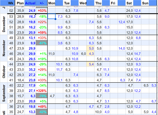

Image of part my old summary view that I used for years. Just to grab attention.... RIP:

    Yes, I have seen garth and two other python projects that seemed to have survived garmins antics, so far...  Its a race to the bottom, I always find it sad when companies create strategies that target its own customers.
    You assume that "my way" was not cloudbased - that assumption is actually incorrect:
    What I had before was in fact cloudbased. No local downloads, no excel. Just REST APIs, javascript running on the cloud and in this case google sheets to display the data. I could trigger the workload from my phone. Worked a charm for years.
    "create your own service that uses the API" - what is this API you mention? I hope you don't mean the garmin API that comes with a hefty developer fee? That has been discussed before, and is certainly not an option for any end-customer. Buy a watch for say 1k and then to get your data you pay... What did it cost? 10k or 5k or something?
    The calendar totals do not respect the filter, I've found. Likely an old bug, but if you set the filter to running activities, the weekly totals do not add up. It will add walking, swimming - everything. With some work, the calendar view might work accurately and will have been more usable.
    The progress summary report is not bad as a raw data view. Too bad it is not applicable to my use case since you cannot get to it, even though I have my data public. It looks awfully alot like the json data on the aforementioned activities list page that was closed down...
    But I think you are right in that the python scripts are the only working approach today, save for using strava.
