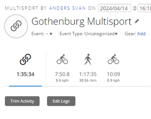

  • Thanks for the step-by-step explanation! Sadly, I don't see the options "Trim Activity", "Edit Leg" and "Divide Leg". I can only change a leg type, for example from T1 to bike. But then I'm stuck. Now I have a multisport activity with swim, bike, bike, T2, run. Better than before, but still not ideal. Did you always record your activities as single sport activities and split them afterwards? Maybe you get more editing options if you do it this way.
  • Make sure you haven't clicked on any of the legs before you click Edit. Click the Multisport symbol left of the legs. But I tested to click the leg and then Edit leg and could then divide it into more legs so that didn't really matter much.

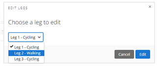

    I've now tested it with a multisport workout.
    Click Edit.
    Then Edit legs.
    Select leg to edit.
    Select Divide leg.
    And split the leg into another leg or transition.
    It works just as with the normal activity.
