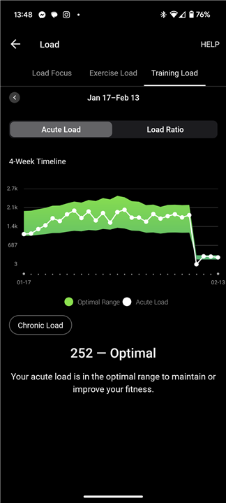

It looks like my training load dropped suddenly a couple days ago. I'm not sure if this coincides exactly with training status disappearing or not.

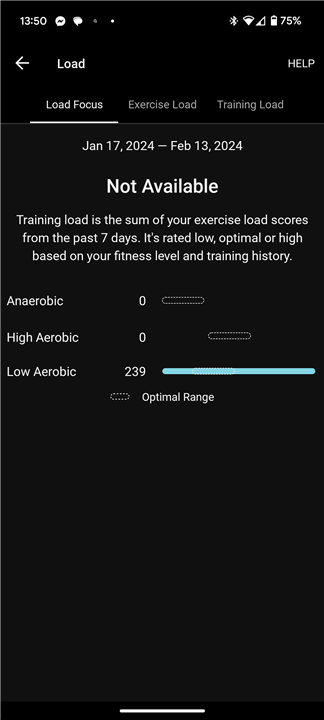

  • Verify your body parameters - especially the weight, but also the height, age, and the Resting HR, Max HR. If the values got accidentally changed to some extreme values, it could have a big impact on the Training Load too. Seeing all the load focus is in low aerobic, perhaps the Max HR is set too high.
  • This all looks normal. I have a Garmin scale so weight gets updated daily (looks normal) and height and heart rate data look normal.
    The low aerobic focus looks very high because the activities prior to 2 days ago appear to have been dropped completely from the load numbers. The last couple days I've tracked some walking, yoga, and a long but low intensity ride.

    • My acute load dropped from 1785 on Friday to 3 on Saturday. On Saturday I did a bike ride (load 156), a run (load 157), a walk (load 9), and yoga (load 3). I suspect everything prior to yoga got dropped from the load estimate for some reason (including activities prior to Saturday)
    • I did a bike ride today and it was factored into my load, which now looks more balanced (see below). Everything looks super high because my chronic load also dropped (from 1436 to 219) when acute load did.
