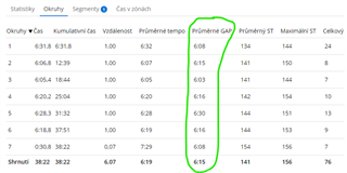

No lap average GAP with auto lap OFF
The lap average GAP value is missing if I have Auto lap function off. I used it for hilly segments.
Auto lap OFF:
Auto lap ON:
Could someone please try that too? Thanks!

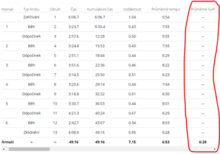

  • So I did a test yesterday. The average GAP is working each time. No matter of auto lap and lap button settings, but the average GAP disappear immediately after editing - changing type of intervals. So it must be GC web bug.
    Just try it, edit intervals of any of Your running activity and change one interval and the average GAP values dissapears.
