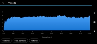

Screenshot from tda app (android app here just for convenience), look at the AVG speed:
but the real correct speed was stored in Connect if you look into the analysis:
so must be something it did at the end of the workout when uploading to Garmin connect.
