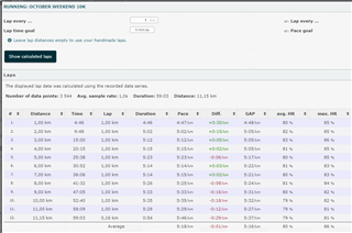

  • Then try https://runalyze.com/
    I use the free version and can recalculate the laps to whatever distance or time I want.
    This is when I recalculated a workout to every 1 km.
