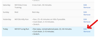

  • Yes, in Garmin Connect Web, you can go to Training Plans and edit the workout to your liking:
    At least this is possible at the Self-Guided training plans. I am not sure it is the same at the Coach Plans, since I have none active, so cannot test it, and it is already a long time ago, I did one.
  • I don't have this type of view for the type of training plan I am talking about
  • Well, in that case, if you really need the editing, then I am afraid your only option is stopping the Coach Plan, and choosing one of the many Self-Guided Plans, where the editing is available. You can also suggest a change to Garmin through their form at Share Ideas | Garmin, but that won't help you either with the current plan.
