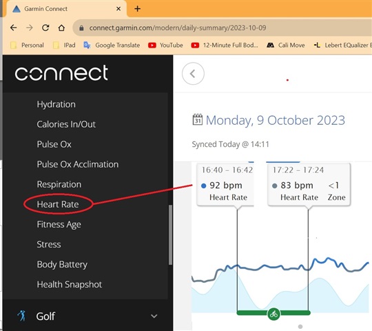

Here on the picture you will see that I did a 90min, Standard FTP test (Not a Ramp Test).
In Zwift, I get a 5min at 225W making my heart rate go up to 157bpm.
When I start the second stage at 225W for 20min, my HR goes to 160bpm.
The same HRM Pro+ is sending HRM Bluetooth signal to my Zwift App and Zwift get it right.
Garmin record (transfer from Zwift) the same data (the right data) and even create a better (more detailed) graph of that same 157-160bpm.
But when I go to the Health Stats/Heart Rate, it records 87 and 104bpm.
Those Health Stats/Heart Rate data are the one Garmin use to give me my metrics, according to my watch's metrics.
It has a direct impact on all my metrics. Even my fitness age have increased by 6 years.
Never happened with my Fenix 5X.
So, guys.
I need your lights on that one.
Thanks in advance for your support.
Sorry for the picture, cannot have a better clarity.

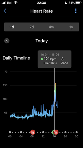

  • Yesterday, I wore my HRM Pro+ all day while working.
    It was connected to my watch and to my IPhone8.
    My watch always recognize my HRM Pro+ and connect it from the moment I wear it.
    There is a buzz sound and vibration when it occurs.
    IOS is up to date.
    Started my Standard FTP test in the afternoon.
    Same thing happened when I did a second ride as a Standard FTP Test and I got the same results.
    30-60bpm less on the Health Stats/Heart rate in Garmin Connect.
    As for the "smoothed out", even if there is a 2min delay, over a 55min training, where there is a 5min and 20min at 160bpm, this is over a 15 and more readings so it should have shown many peaks, that would have been smoothed out and level at 157 and 160bpm during the training time.
    If the HRM would be the problem, it wouldn't have done differently in Zwift and in Garmin.
    This is yesterday where I wore my HRM all day.
