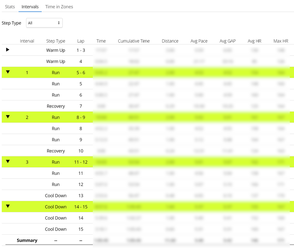

    Where this becomes powerful is that you can filter this list by workout step type. So I can choose to view only the run ("work") intervals which would exclude warm up, cool down, rest and recovery. That way I can see my average pace for the entire "work" part of the workout.

    Example of what I'm talking about with running (the values in the summary line change depending on what interval/step type is selected):
