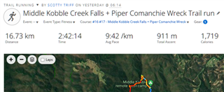

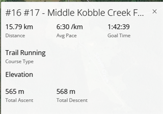

Planned this run, Garmin Course planner says total Ascent is 565 m
After the run:
911m Elevation Correction. 1,007 m watch recorded (Strava also matches what the watch and corrections come up with)
As you can see, almost 400M more in real ascent, and did I feel it, really struggled and not prepared for this (coming back from injury)

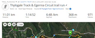

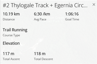

Another example:
117M total Ascent in the Garmin Course Planner
Actuality it was 406m Elevation Correction. 368m watch recorded.
Every Course I've panned is always under, and by a significant amount.
Longer runs 20km + just get worse...
