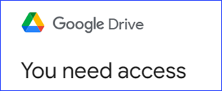

Hi Folks,
Could someone please fix my corrupted fit file?
drive.google.com/.../view
Thanks,
Stephen
  • Can you make your link public and/or accept my access request?
  • Former Member
    0 Former Member in reply to StephenCahalan
    hi,
    both links work now fine
