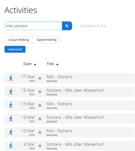

  • Duno, when I try - it does check words in order.
    After changing words' order to a wrong one - I get no results.
  • This is how my result looks like. How do you search?
  • I search on the same page, tried with all activities and with selected category (no difference).
    BUT indeed it seems to be broken or it works in some strange way.
    For some specific words combined together it doesn't work. When I search one specific name - it displays results with it, but after adding second specific word, it ignored the first one giving results by the second only.
    I tried also creating 2 activities with names as on your picture, and you're right - search order doesn't work for them.
    Can't guess what makes it, for names I usually use it works, but not for all.
