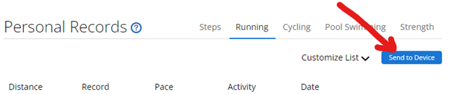

  • I am not certain whether it helps, since I cannot test it (my streak is all right on both ends), but in your place I would connect the watch with the USB cable to a computer with Garmin Express, go to the Personal Records page in Garmin Connect Web, and then try sending the records to the device. Although the button "Send to Device" is not available on the Steps tab, you can use the function for example on the Running tab. There is a small chance it could sync the steps streak together with the other records to the watch too. Please report back whether it helped or not.
  • trying it will let you know...tks
  • Thanks for the suggestion but it did not work but it did give me the idea of trying setting the watch to factory and then syncing it again. Already past my goal for the day so will see tomorrow if it works.
  • Did not work for me either, and I am NOT going to do a factory reset. Too much trouble restoring everything, so I'll continue to ignore it like I've been doing for the past year or so.
  • Yeah that did not work at all... Did not upload the info from connect. Worst thing is an app i was using for tennis that was rock solid is not all flake after reloading it. Now I just wish there was a way to disable that stupid streak notification on the watch since it does not really serve any purpose anymore.
