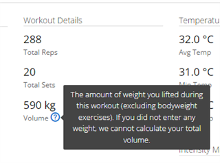

    I do not quite understand why you are looking for the total weight in the FIT file, which is not that easy to handle, especially if you are not a programmer. The total lifted weight is directly in the activity stats in Garmin Connect, under the label "Volume", so you best use this value directly.
    If you need to pull it from that page programmatically, then you can either parse the HTML, or load the JSON data, using the exerciseSets request - see it with the Network tab of DevTools of your browser. However, unlike on the HTML page, on the first glance I do not see the total volume in the JSON, so you may need to sum it up yourself.
