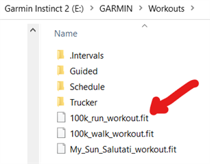

No, the workouts on the watch are in the FIT file format:
JSON is used just for transmitting data (not only workouts) to Garmin Connect Web, but you cannot import them anywhere in Garmin Connect, so I do not know what you intend to do with them, If you want to transfer the workouts to your watch, then you can use the FIT files directly.
