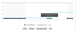

Zwift activities are missing from weekly intensity minutes completely

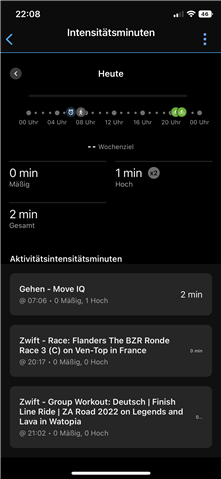

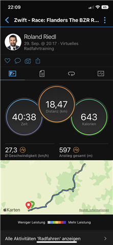

So just to give a update on the situation:
I did pair up the Garmin HRM Pro Strap with my iPhone and after the activity I was clearly able to see that Garmin Connect did show to items syncing: the Fenix 6X and the HRM Pro. After that the situation is unchanged and it is pretty hideous. Two activities with every detail imaginable, and 0 IM's. Clearly a bug on Garmins side that appeared sometime in August this year.

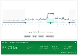

Please post a link to the concerned activity, and a screenshot of the all-day heart rate graph for the same day.
I don't know, I have had notoriously bad Optical HR when biking or on my indoor trainer if I forget my Strap or something casual like a rental bike downtown, I always figure 'oh my arm is fairly still and watch is tight, should get good data'... then it is the same old junk (235 and 945 watches).
