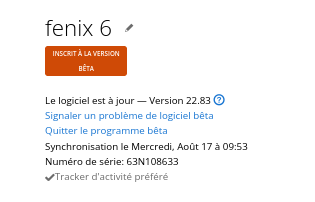

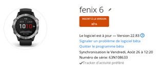

The screen-shot indicate that I run 22.83 (which is the actual firmware on my fenix6) nevertheless, 2 beta and one CR have been pushed since (23.00 has been announced 7 days ago)https://forums.garmin.com/outdoor-recreation/outdoor-recreation/f/fenix-6-series/306162/system-software-23-00
But as of today 2022-08-30 the device's page in Garmin connect is still telling me i am up to date ("le logiciel est à jour"). The synchronisation with the device is ok ...so to me the problem rely in the back office, during the interrogation of Firmware status.

    If you are sure that the test is actually : Test if fw version is >= 22.10 (22.10 being the last official version) than probably the test should be adjusted for the fact that you are in beta program or that you run an "unofficial release" (here are two screenshot done when I was in the beta program the first was on 2022-08-17 two day after 22.85 release and the second is on 2022-08-26 8 days after 23.00 release (as a RC not as the official which was announced the 2022-08-23)
    Do we agree that at that time, being in the beta tester group, the message could have been misleading (despite a logically correct test since 22.83 in all the case is in fact greater or equal to 22.10).

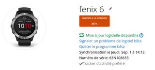

  • I had the same problem when 23.00 was still beta. I checked it like 10 times every day for 5 or more days 'till it finally started to be downloaded to my watch. What was interesting is that I downloaded the Explore app for android: https://play.google.com/store/apps/details?id=com.garmin.android.apps.explore and it did correctly show that there is an update. And when I exited the beta program and checked it after a minute it showed that I'm on the latest version. And when I enrolled again it showed again that there is an update. However Garmin Connect Android didn't think so. And the Connect website didn't think so. Garmin told me to unpair the watch from my phone and then re-pair again, which didn't help either. And suddenly after another few days it started to download it (when you go to GCM > menu > Garmin Devices you should see that it's either "Syncing" or "downloading software update" (or something similar))
    I still don't know what fixed it, IMHO there was (or according to your report still is) a bug in Garmin's apis. My guess is that the Explore android app uses some api to check for updates and the Garmin Connect android app uses some other api (which seems to be buggy)
  • Hi thanks so much for your reply (You were my last hope to  get thing fixed).
    Explore App, did succeed to get the information correctly display in Garmin Connect Web after I sign-in to the beta program. (Otherwise the message was still that I was up to date)

    While writing the firmware Download is on its way. I must says it's a tad bit longer than the download and copy via USB-cable that we use to have in the previous beta . Perhaps allowing a plan B (old fashion) for firmware upgrade could have been wide !
    Anyway thank you again for your help Gavriel.
