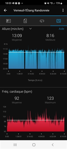

However, I went for a 37,3km hike/walk a couple of days ago (rather low elevation, 8 hour activity excluding any break, average HR of 92 - which seems  a little low to me -), and used the "hiking" profile on the watch. I'm 175cm, 68kg, activity class not set at the time on my user profile, but although I walked continously for 8 hours the total calorie burn displayed was only 1537 kcal (942 active and 595 passive). This number seems ridicously low compared to (i) my previous walks with my Polar watch and (ii) considering the effort put in for the body. But most importantly, when I look at the daily recap, the app says I walked 40,2km/54.783 footsteps that day (= hike + trips going and back to the hike departure and arrival not recorded) and here it says all these footsteps represented 2811 kcal which seems way more accurate. If I do the math based on the footsteps calorie count, the activity calories should have been of 2600 kcal and not 1537!

    Here's my HR graph which I find low because I didnt walk very slow that day, and I'm usually easily towards 100 BPMs when walking a bit fast.
    The daily HR graph would have been better, because there we could see also your Resting HR (RHR). You get Active Calories only for the time when the HR is higher than the RHR. And the higher the HR is above the RHR, the more Calories you get. Hence, if your 7 day average RHR is high, and the HR during the activity is low (like in this case), then it means there was only low effort, hence low energy consumption (low Calories). The number of steps is irrelevant. What counts is the effort, and that is measured by the HR.
