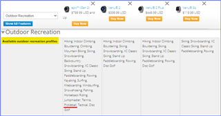

If not available natively for your watch, search the Connect IQ store.
Pickleball doesn't exist as an activity type in Garmin Connect, but there are some watches that got an activity profile named Pickleball which I guess is only the activity type "Other".
Tennis exists and a few watches supports that type.
The Venu and Vivo watches do not support that many activity profiles (not the same as activity type): https://support.garmin.com/en-US/?faq=srpP0JRZAj8ffbOMoTgNU7
Some of them got no corresponding type in Garmin Connect and will be reported as "Other".
To get access to the highest number of activity types you should use Forerunners and Fenix watches. In those watches it is also possible to create custom profiles and rename them to whatever you like. The Vivo and Venu watches that support custom profiles do not support renaming them...as far as I know.
Depends on your watch. Some of the newer higher-end devices, such as the Fenix 7, Forerunner 955, and epix, have Pickleball as an activity profile.
Otherwise, you can request it be added to the Garmin Connect activities list here - Share Ideas | Garmin
Also, to the OP RollTidde, there is an option for tennis. You could change the activity type to tennis after synching with Garmin Connect.
On your watch go to settings. Scroll to Activities & Apps. Use the + sign at the very bottom to add new activities. Pickleball will be there
This is not available on every watch, as already mentioned by seilogramp.
And not on the Venu SQ, the watch mentioned in the subject of this thread.
