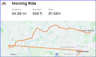

I have tried using the Fitfiletools repair tool to fix the corrupt FIT file without any success can anybody help?
I can only get 1.6 miles of a 65 mile ride. Graph seems to end up in the Alantic Ocean2022-04-02-08-14-27.zip

This will upload to Garmin Connect (and strava), but still with issues - 2022-04-02-08-14-27-fixed.fit
I removed the erroneous timestamp using Fit File Repair Tool
This still leaves a large gap where your Edge 510 was not recording any GPS activity.
