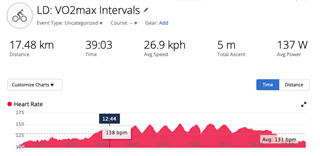

I have noticed some missing data on Connect web and iOS started this week. I have used this same gear for several months previously with no issues.
1. Recorded activity from Edge 530 with HRM-Pro shows HR correctly when viewing the activity. But when viewing the "Health Stats" page on connect web and in iOS it shows a gap for HR during the time the activity was recorded. It looks like physio true-up is not working, but it has always worked previously! This has worked previously on HRM-Pro 7.4, and worked at least once with version 8.1 but for this activity it has not worked. I also notice that intensity minutes has not been added to the connect screen. Is there a problem with 8.1 on the HRM-Pro or is it some other glitch?
Example 1: Edge 530, HRM-Pro:
