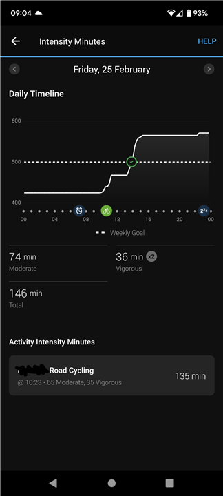

Until recently everything has worked fine but yesterday I did a 40 mile ride and although the ride and all the stats show in Garmin connect non of the details of the ride contribute to my daily stats such as activity minutes or heart rate stats.
What has gone wrong and how do I fix?
