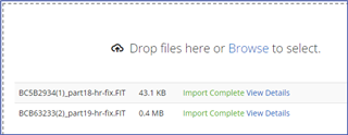

Can anyone fix FIT corrupt files?
Yes. Just attach it here.
BCB63233(2).zipThanks. Hope this works
I have saved both files as I normally save any other of my activity's. I have had this before with open water swims where I can see the data on the watch but it won't load to GC.
The 2nd larger file is a long brick session which I used the Triathlon activity on the watch.
Hope this helps
Cheers
Dave

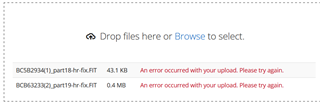

Still getting the same error
You must delete the original activities from Garmin Connect. The process checks for similarities and rejects a new upload if it suspects a duplication.
