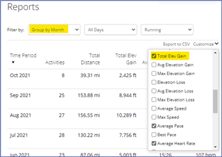

I've looked through the reports and don't seem to see it. Periodically, there is a challenge to climb 20,000 feet in a month. Would like to see my progress over time, just can't seem to figure how to do it. Thanks.

Will this work? https://connect.garmin.com/modern/progress-summary
Filter by: Group By Month, Customize check "Total Elev Gain."
Thank you! That does help! It doesn't look like you can add the report to a dashboard on connect.garmin.com but this is the next best thing. Much appreciated!!
