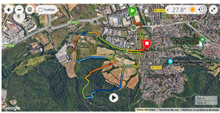

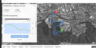

as I notice that some segments had disappeared i decided to create new ones. I chose a running activity and I click the creation tab, I'm transferred to the creation page but only the middle part It's vailable to move around the end and start.
Usually -I've tried it with several running activities- the first and last km- are not considered and I'm not able to reach with the start-end tool.

    Example:
    ACTIVITY
    SEGMENT
    As showed above only the middle part it's available to select
  • Looks like a bug, but I didn't have it yet. Normally a middle part is selected by default, but you can expand it further for a complete path.
    If this happens with every activity, then maybe try changing some settings, earlier there were bugs depending on number format or language (but it doesn't seem to be the case this time, maybe something else). Or maybe try how shortening editor works, if it shows full path or it's the same as here.
    Or try reporting it directly through contact as a bug.
  • Yeah probably as It happens with all them, I'll tweak some settings see what happens. Also I'm contact with SAT but so far didn't happen to them either
  • Solved! It is the zone/area privacy you establish on some locations to hide your star finish point.
