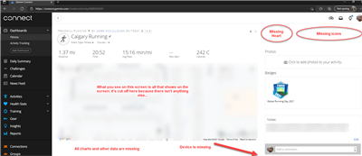

So, GC is doing it again.  I'm missing all kinds of stuff on an activity.  Hey, I've made it shareable with you via the site.  A screenshot of what I see:
What I've noticed is that it does THIS when it pegs out my location and adds it to the name - "CALGARY running" - and it doesn't do it when it uploads just "Running".  This makes little sense to me, because when I start a run, I select to NOT use the GPS because I'm on a treadmill...  If my movement is tracked by GPS on a treadmill, that's a Bigger Other Problem.  But it seems to be random as to whether or not it picks it up.

  • I checked your activity from yesterday and it looks all good. There is no map when I view it. I also see the charts and the device.

  • Thanks man.  I thought you were a master of .FIT files, too.  Probably because a) you're a coder, and b) your website is awesome.  Regardless, checking the thing on "public" mode, yeah, I see all the charts and stuff that I don't on my own frikkin' dashboard.  :(  Thanks Garmin.  So at least I know the information is captured, even if I can't directly see it.  That's helpful to me at least.
    Looking at the console as recommends, I see some stuff hasn't loaded.  I'm not a web-wizard (I code integrations between systems in C# and other .NET languages, mostly) I haven't got a clue what I'm looking for.  I *do* have an uncaught exception "cannot read property '0' of undefined" ... that sounds helpful...  LOL  But it's by far the biggest code-bust in the console.  And incidentally, the code does NOT break when opening in an incognito window...  So it's probably that.

  •  I've taken a look, and yeah, got the error and where it is.  It seems to have something to do with the map:
    getHotlinePolyData: function(e) {
    for (var t = [], i = this.activityDetails.get("directLongitude"), n = this.activityDetails.get("directLatitude"), r = 0; r < e.length; r++) {
    var o = e[r]
    , s = n[r]  // <-- right here.

  • this.activityGearView.render() is after that place I mentioned, and function from your post is called from the beginning of displayActivityModel. So if you have error there, then probably it doesn't do next steps.
    That polyline function is not called on activities without a map.
    If your activity should be without a map, then you could check why it was called by viewing some variables used in displayActivityModel. Or maybe look how polyline's file looks like (should be only: numberOfPoints: 0):
