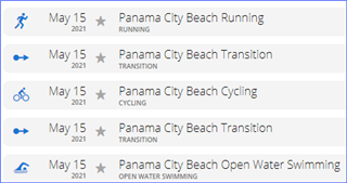

  • Sorry, what do you mean by that? Tried to do a reconstruction multisport file with the Edge version of the bike leg and a shortened version of T1 as I requested and that was not successful for some reason, or that you did what you posted yesterday with the changed bike lap button push on the original 945 multisport file and that’s where you’d like to be finished? If the second, could I ask you to do one last thing, just extract the 5 legs from the original multisport file into their own independent activity .fit files and share? Then I can have the triathlon accurate in my Garmin Connect with all of the available data, just as separate activities Old School. Is that a reasonable ask?

  • Running the software is not an option unfortunately as it requires Microsoft Access and there is no version of Microsoft Access for Mac. Fortunately, in the FFRT FAQ, question 3 is "Can I split a fit file into multiple files?" and the answer is yes. And question 2 indicates that trimming activities in a fit file is supported. So if someone could simply split the multisport file into 5 parts that would be nice progress. To have the triathlon represented accurately in my Garmin Connect, I just need to 2 simple steps that I unfortunately don't have the tools to do at my disposable but seem straightforward with Fit File Repair Tool and other methods may work too. Those two steps are:
    1. Split up the multisport activity from the 945 into 5 parts.
    2. Shorten the Transition 1 activity from 07:56 to 04:45.
    Then share the 4 original (swim, bike, T2, run) and the edited T1 files. Greatly appreciate getting this over the finish line!
  • Thanks very much for trying! Would you be willing to do just one more thing - just extract the multisport activity into five separate activities and call it a day?
  • just extract the multisport activity into five separate activities and call it a day?
    Here ya go - tednyc.zip
  • Yay! Amazing! Thanks so much!
