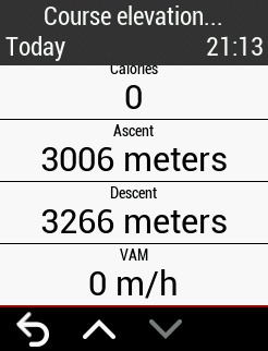

Hi, since last week, I have been experiencing problems exporting courses from web or mobile Connect to Garmin Edge 830. Ascent/Descent meters are two to three times bigger than reality – than in the route prepared or imported into Garmin Connect.
I found that the cause is in the FIT file. When I download the file from Garmin Connect and analyze it using for example https://www.fitfileviewer.com, I see that the incorrect altitude values are already in this file.
When I load this FIT into Edge, the route elevation data shown is incorrect. When I use GPX, everything is fine. But Garmin uses the FIT when synchronizing.
You can try it yourself with this shared route: https://connect.garmin.com/modern/course/58498287. The elevation gain shown in Garmin Connect is 1134 m. After sync with Edge I see Ascent 3006 m (or after FIT download and analyzing).
This behavior began around May 6. Can anything be done about it?
