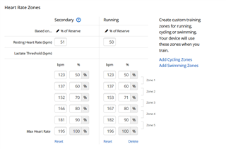

  • If you look at the Time In Zones tab in Garmin Connect Web, you can see what zones GC thinks you've got set. Unfortunately this doesn't show max HR (anymore), but you can at least see if the zones themselves are close to what you expect.
    If they don't match what you expect, check GC and your watch to see if the zones match up. Depending on your watch, you may also have sport-specific zones for running, swimming and cycling.
    Your HR zones can be found in GC under
    [Watch Icon (upper right hand corner] > [Your Device] > Device Settings > User Settings
    e.g.
  • Thank you Will--that was very helpful. I found my max HR setting using the path that you described,and it was set to 167.
    I had never set that value. I changed it to 190.
