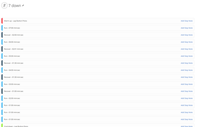

I have a garmin 410 and when trying to upload a workout to the device the device says transfer complete but no data passes across and the advanced workouts are empty. Sporadic sync issues as well but generally my activities transfer from watch to garmin connect ok, its just seems to be the other way is the issue.
