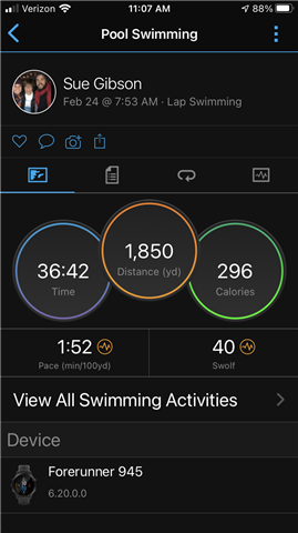

This from the same swim shows two different paces. The 1:52/100 is correct. Anyone know how to solve?
The 1:15 min/100 yards is the moving pace, while the 1:52 min/100 yards is overall pace (including stops). As long as the stops and laps were detected correctly (which is not always the case), both paces should be all right.
Not true. No way can I swim a 1:15 pace.
Yes, that's exactly why I wrote "As long as the stops and laps were detected correctly". Probably not your case, then.

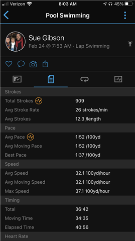

What Moving Pace, and what Total and Moving time is shown on the second page of the activity? (tap the symbol of the document sheet in the header)
It appears that the data collected is accurate.
Actually, the Avg Pace should be 1:59min/100yd, and only the Moving Pace should be 1:52min/100yd. Did you edit the activity (i.e. the distance) after completing? Can you reproduce the problem each time you swimm, or was it just in this case?
