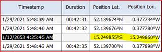

Hi, Can any of the amazing file fixer fairies on here help fix the attached file please?! It should be a 15km run, time 1:27:39 but isn't syncing to garmin connect even with manual upload. I've tried a few file fix tools to no avail myself. Thanks
A bit of weirdness...
Among other issues, all fixed with Fit File Repair Tool.
I see it is from the dreaded Forerunner 35. Notorious for having these issues.

thank you so much for fixing it! Much appreciated!!
